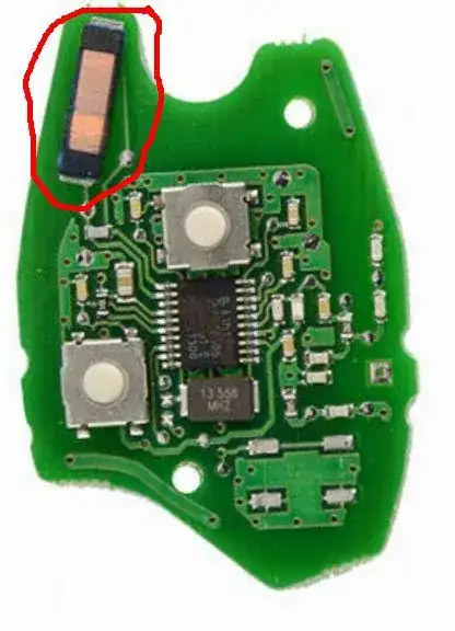

If this happened right after you re-cased your key then the most likely possibility is that you have damaged the transponders antenna on the pcb. They are very fragile. Generally the keyless entry portion is separate so it may still be working even tho the transponder is not.
I'm not all that familiar with Peugeot's since we do not have them in the states but I do know the style of key and believe its similar to the one below. If you have any local locksmith shops in your area you can take them your key and ask them to check to see if it still has a transponder signal.The antenna are easy to replace if its the problem. Its possible the eerprom on the key got corrupt as well but its rare so I would only worry about that IF they key sends signal and your car is confirmed to have immobilizer faults stored.
transponder antenna circled
