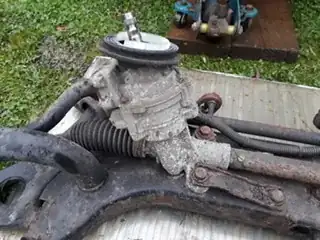

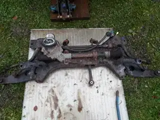

I removed the steering rack from the car, which required dropping the front sub frame -
I could see that the aluminium casing was badly corroded -

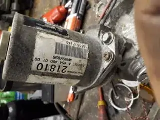

Some of the joints between different components appeared to be swollen due to the corrosion, for example where the steel casing of the motor mated up to the EPS body -
The bolts were difficult to remove and one of them snapped, so I had to drill it out.

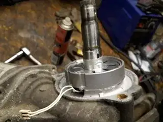

I also dismantled some of the EPS body -
With the EPS disassembled, i again turned the input shaft and found it to be move more freely than before. Not finding anything obviously wrong, I cleaned all of the mating faces and reassembled the EPS. The assembly was still easier to turn by hand.
I believe that the corrosion between some of the mating faces was causing miss alignment of the components, which was causing increased friction. For example, the motor casing was probably slightly twisted due to the corrosion.
