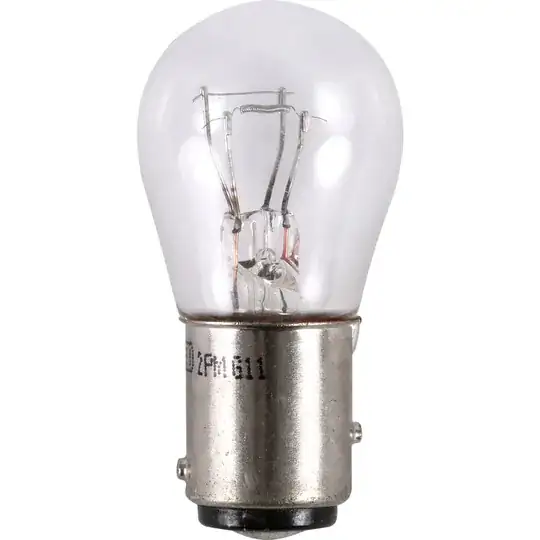

If it is a 21W/5W bulb, then it has 2 filaments of different brightness.
The 5W filament is for the side/tail light for night driving.
The 21W filament is for bright illumination when you press the brake pedal.
Image copied from ToolStation
