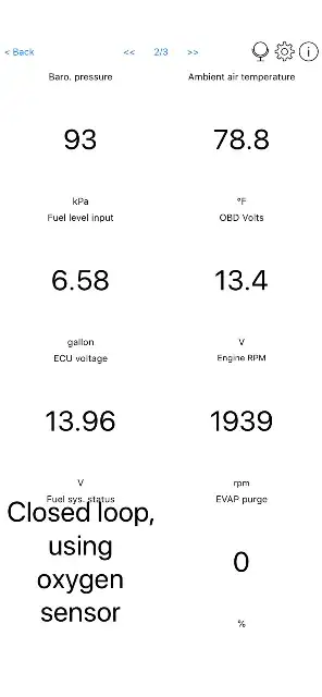

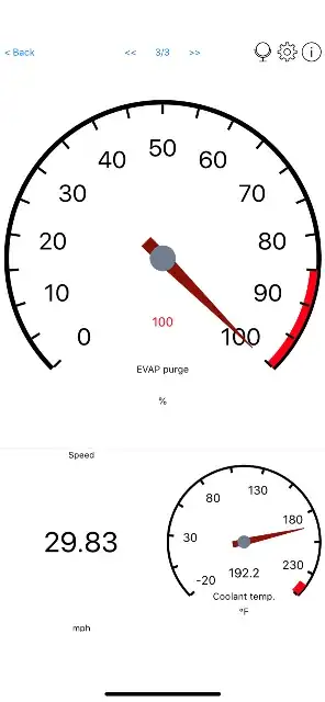

And for reference, here are two of the screens I used during the drive.
OBD2 Screen for Evap Test Drive
OBD2 Screen for Evap Test Drive #2
