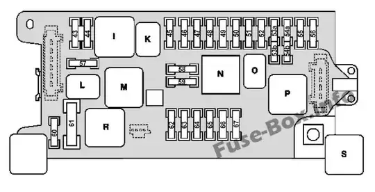

The ESP says it is malfunctioning. in a 2001 Mercedes e320, will that affect starting and where is the starter relay

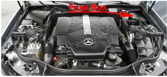

Relay Is designated L in the image below, there is a fuse for the relay and it is #59
Source
Moab
