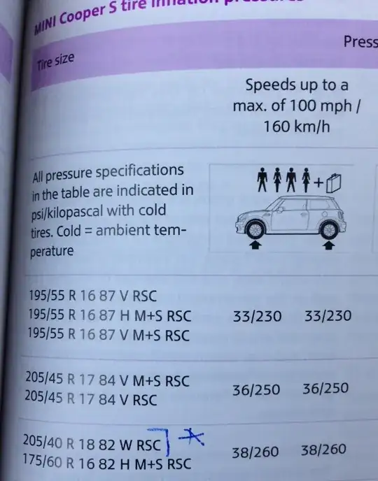

Turns out (oops) a detailed answer is in the owner's manual: For the Cooper S and my size, it looks like 36 psi. (Ignore the asterisk -- that was for my old tires.)
Tire pressure
