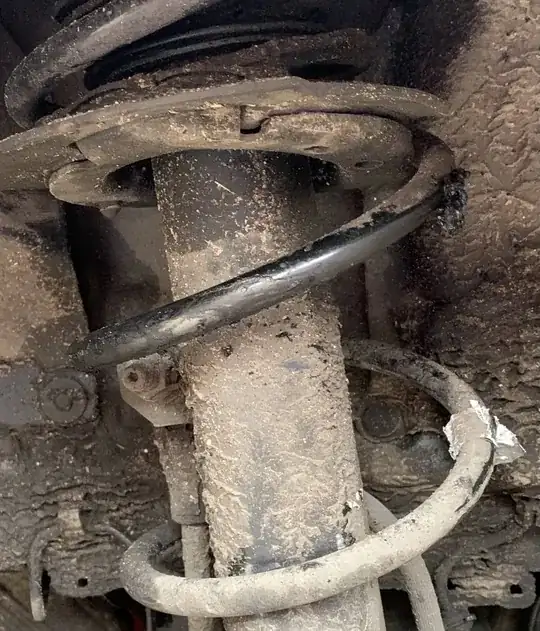

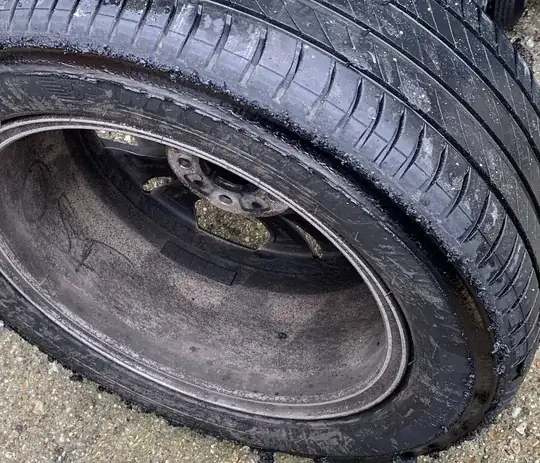

enter image description hereenter image description hereenter image description hereExtremely dangerous, please see pictures Was driving home from work at 30mph max in dark. lucky to get home.Spring broke and slipped down from shock absorber, ate all tyre... Distance traveled 12 miles on wet tarmac, new Michelin Primacy4 tyre turned to mess.. If sharp spring end would contact tyre, it will blow in seconds..
