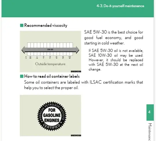

I'm not sure where you got your information from. Here's the page from the 2009 350 ES Owners Manual:
It clearly states to use 5W-30. 20w-50 isn't mentioned.
