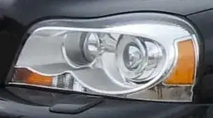

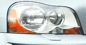

I basically want to go from these:
(image source)
to these:
(image source)

Yep, the Bi-Xenon projector units are plug-n-play from a connector point of view - you'd need to buy the units that come with the leveling motor and Xenon control unit as you can't swap the old ones over.
The ADL (i.e. "bendy light") functionality doesn't work if you retrofit them (you don't have the necessary control elements on the car side of the equation) but the lights default position is "straight" anyway so it won't impact anything.
Everything else should work fine for you since you already have HID lights you'll have the auto-leveling control sensors and control software already.
For a RHD car the left headlight is Valeo part# 043518 and the right is part# 043515

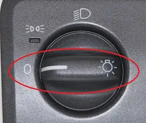

OP here. I replaced the stock reflector xenons with ABLs and they may or may not work depending on your car's configuration.
If you turn on the headlights by switching the switch to the 12 o'clock position: enter image description here,
the ABLs will point straight down and you get a warning in your dash. Therefore, the accepted answer is wrong, specifically
[...] but the lights default position is "straight" anyway so it won't impact anything.
However, if your car is configured so that the headlights turn on when the switch is at 0 or 9 o'clock:
Then the headlights turn on and they're aimed properly and you don't get any errors.
The downside to this is that you can't permanently turn on the full beam on the 0 position, you can only flash. If you switch to the 12 o'clock, as I said above, you get an error and the headlights are aimed down as low as they'll go.
If your car is configured such that the lights are off at the 0 position, well, the lights are off.
