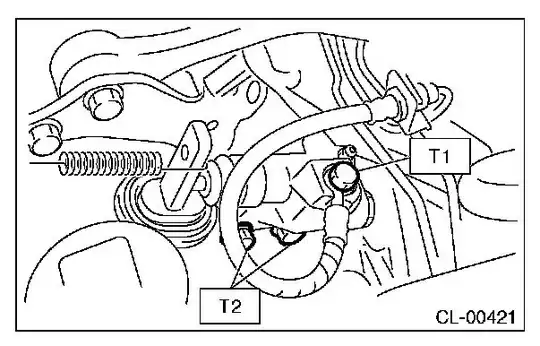

I would take a look at the slave cylinder. If you are wearing out master cylinders something is not right.
It may be the slave cylinder has worn away a pocket in the release lever. This is supposed to be lubricated with special grease. It's not easy to get to, but it is external to the transmission.
Check the interface to see if there is rust or abnormal wear on the release lever.
