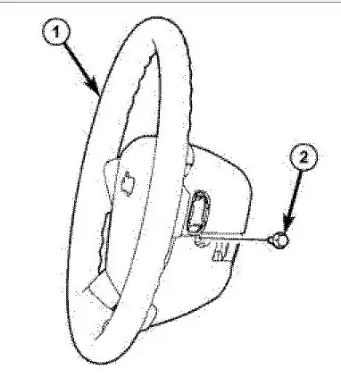

You'll have to remove the airbag from the steering wheel. There are screws on the side.
You MUST disconnect the battery negative terminal and let the vehicle sit for a few minutes before proceeding.

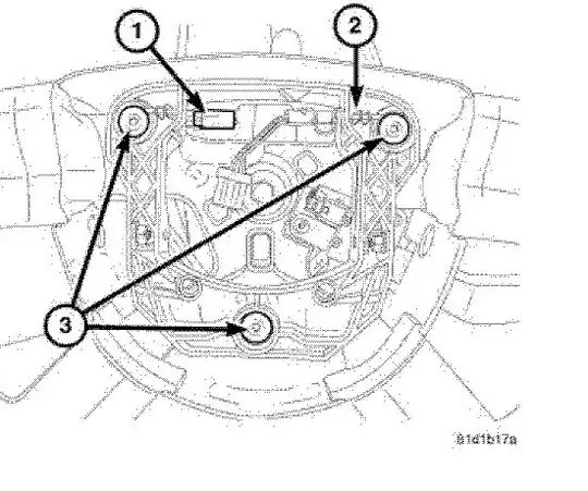

Disconnect the electrical connector for the horn bracket and remove the 3 screws.

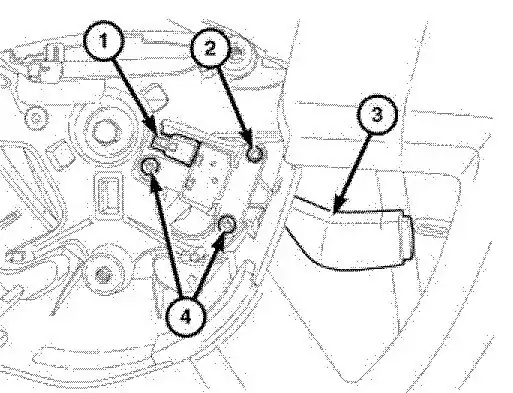

Disconnect the cruise control stalk electrical connection, and the small screws that hold it.
