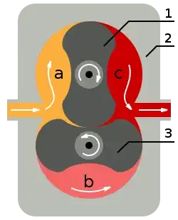

ok this is the image of a Roots blower supercharger used in a Pontiac as suggested by Bob Cross so as you can see there are two lobed rotors so maybe the central rod on which they are mounted (i don't know what they are called) would have been worn out and got loose so the rotor would have moved a little bit from the axis and would be rubbing with the other rotor that would be producing the roaring sound
and at a higher rpm the flow of air and the speed of rotation would be causing the rotors not to meet for a long time to make that sound. I think this is a problem as i am not a pro so just take it as advice
