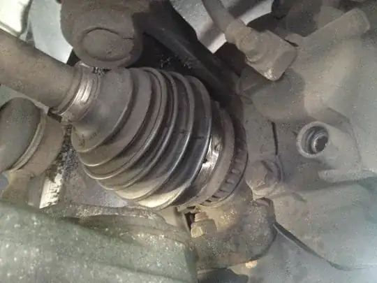

I discovered a small hole, possibly a puncture, in an outer CV gaiter on the front. The hole was right next to/under the (outer) metal ring holding the CV gaiter, so it wasn't in a very flexible bit. There was quite a lot of oily grease splattered on the inside of the wheel (and presumably much of it also went onto the road). The hole was then closed using silicone sealant.
What I would like to know is if the grease that was blown out of the CV gaiter still had a function, or whether grease that has reached the CV gaiter's "wall" is not useful anyway, because it doesn't go anywhere normally. Should the missing grease be replaced?
NB: Given the position of the hole, and the fact that the grease was pushing out, I'm fairly sure that nothing went into the CV gaiter.

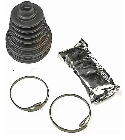

Here is an example of a boot kit, this one is $15.99 and fits a Dodge Neon

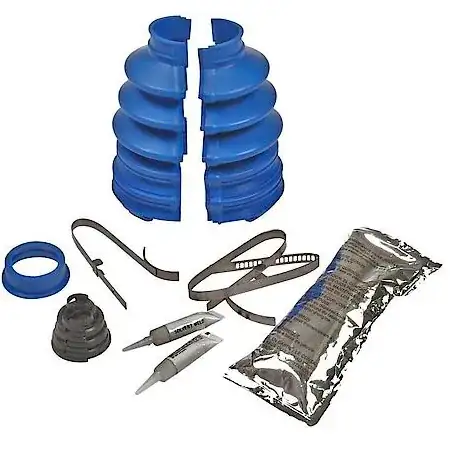

This is the split boot type that I don't recommend.

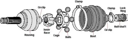

Here is an exploded view of the outer CV joint. It's best to disassmeble when cleaning the old grease and dirt out.
Remove the shaft, and throw the boot away. Clean out the old dirty grease, after cleaning the part of course, and replace both the grease and boot. This gives you a chance to inspect the joint, and clean up any dirt residue that will speed up the deterioration of the CV joint.
