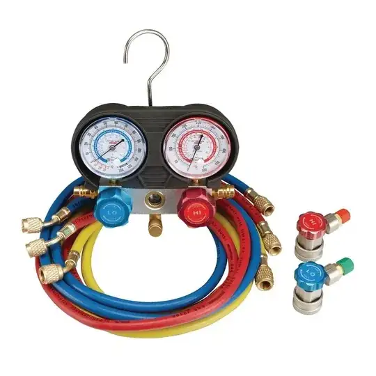

First, you'll need a gauge. This is the thing that will tell you what the system's pressure is, and (importantly) also connect your hoses to the car and the coolant cans. Get one with two gauges on it, so you can see the pressure on both the high and low side of the car. Importantly though, you need one that reads down to 30in-Hg (that's inches of mercury - equivalent to 0 PSI absolute, or -14 PSIG "gauge") so that you can test a vacuum.
Note that these "manifold gauge sets" are refrigerant-specific, as the fittings that are provided for one kind of refrigerant will not attach to a vehicle that uses a different chemical. The most common is probably R134a, unless the vehicle is very old and uses R-12. A very new r1234yf refrigerant equipped vehicle requires some specialized equipment, and may not be a good candidate for a "DIY" refrigerant recharge.
(As an aside, if you have an R-12 vehicle, now is the time to retrofit to the newer R-134a refrigerant, as R-12 refrigerant is almost completely unavailable.)
AC Gauge

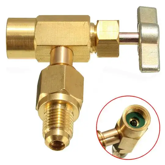

In addition, get a valve so that you can open and close those pressurized cans of r134a at will. Note the spike in the valve. You screw it on the can with the valve open, then close the valve to puncture the can, then open it up when you're ready to let it flow.
R134a valve

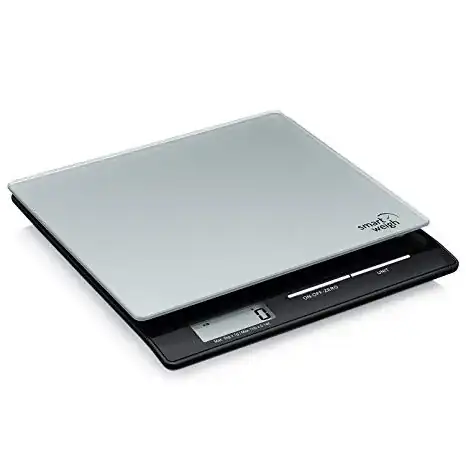

You'll also need a postal scale to measure how much coolant you're putting in. It should measure to a 10th of an ounce, and have measurements in ounces and kilograms. Those are the two units I've seen cars spec'd in. Of course, it's possible to simply convert to your unit of choice, so don't sweat that too much.
Cheap Postal Scale

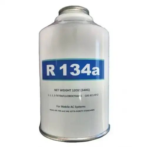

Finally, you'll need some refrigerant and oil. This is the most important part. Your A/C system is designed for very precise limits for performance, so you'll want the right amount of refrigerant.
R134a Can

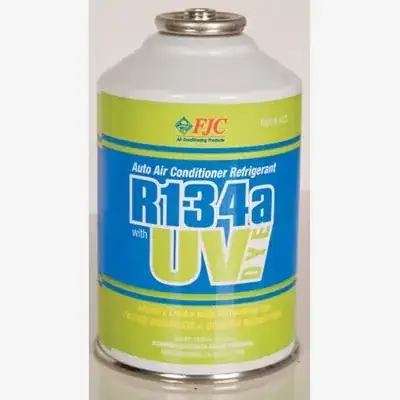

You can also consider using R134a with a UV dye built in. If your car ever leaks refrigerant again, you'll be able to use a cheap ultraviolet flashlight to find where it's leaking from.
UV r134a

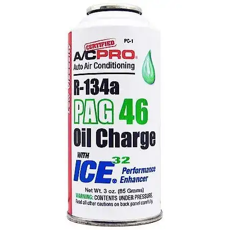

But don't forget the oil! The compressor needs oil to keep running smoothly, so read the spec and get enough oil to put in. Don't get oil in a bottle though -- that's just about impossible to get into the A/C system. Instead, buy it in a can under pressure so that it will feed itself into the A/C system.
PAG46 oil
