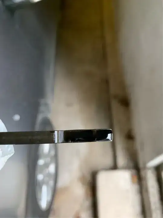

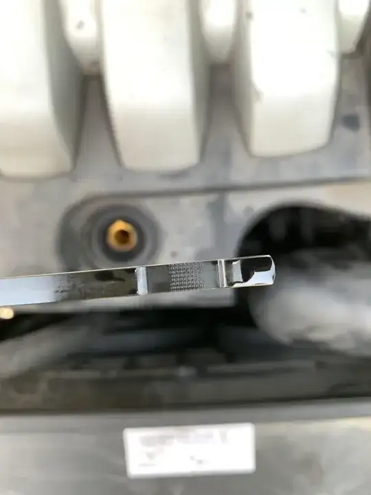

After a few hours I decided to check the oil (obviously it had time to settle) and it was below the minimum.
The oil indicator did not go on that it is below the minimum and even today it is still not indicating that it is below the minimum. Before driving it towards home the mechanic checked the level and it was okay (the car was not working for 1 hour before he did that, it probably had time to settle).
Note that I didn’t had any issues with my car consuming oil. The last oil change that I did was 1500 - 1700 km before this happened and I was constantly monitoring it and it stayed at the original level all the time.
Oil level after oil change Oil level after oil change
Current oil level Current oil level

2: The oil is still visible on the dipstick so that is great, you're probably safe to drive a short distance (as long as there are no leaks that would bring it lower).
The real issue with low oil is, as it lowers you lose oil pressure which is what actually keeps the metal bits in the engine from touching.
Oil alone isn't enough, it must be pressurised oil. Imagine squeezing a garden hose with the water on vs water off, when hose is pressurised you can't press it together easily, this is what stops metal from touching inside the engine.
Since you still have oil on your dipstick, that means the oil pump would still have enough oil to pickup so likely it still had good pressure.
If this was the only issue, I would not be too worried about driving it 15 km to a service station like that. Ideally top it up before you go, but it shouldn't cause any substantial damage (honestly shouldn't cause any).
