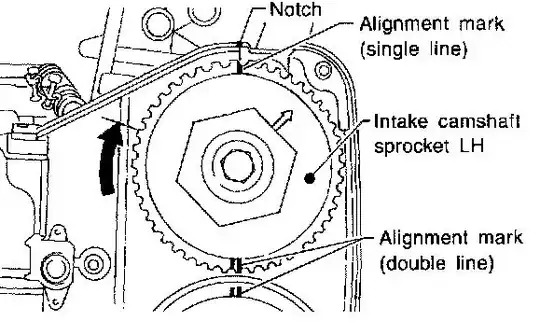

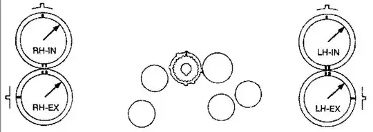

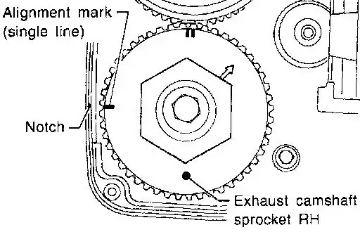

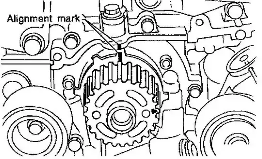

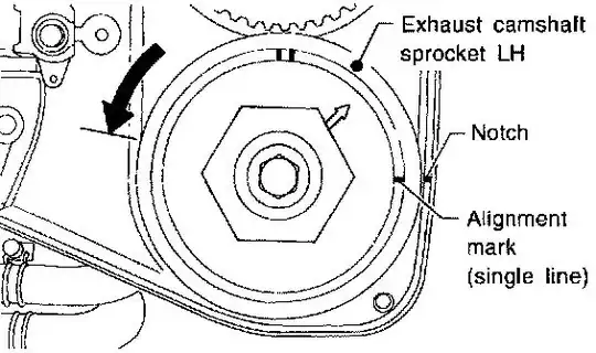

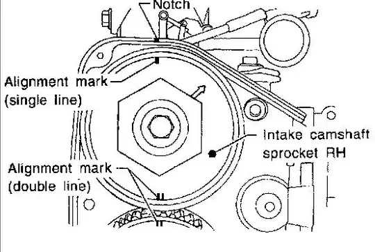

I don't like those "preprinted" marks anyway. You are much better off following the sprocket alignment pictures below.
After the belt is installed and the tensioner properly set, crank the engine over BY HAND (in the running direction) at least four full revolutions, and check that all marks come back to perfect alignment.
I've done dozens of these, and following those silly marks painted on the belt only leads to trouble. Sometimes they are not exactly right from the "belt factory", and sometimes you start with the wrong mark - only to pull it off and start over.
