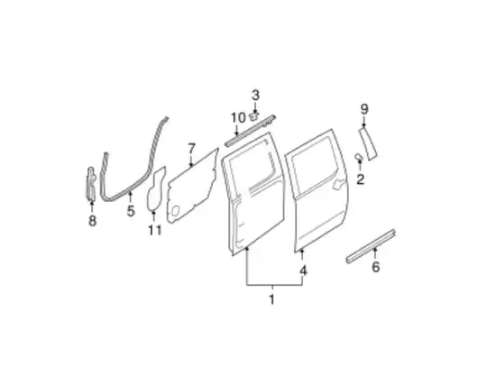

Hope this helps the next Titan owner. Actually the door doesn't have a drain but a seal strip. This is barely in place and after taking a shop towel and cleaning the gunk and buildup did it resolve the issue. Pictured below are the schematics of the seal strip with links in case you need to replace yours:
actual strip for Armada but same part:
part number 6:
site reference
