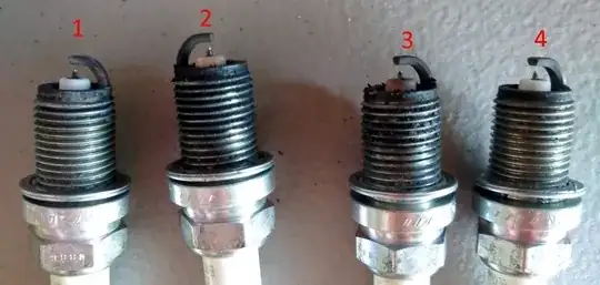

The battery and starter are both less than four months old, and it got a new set of plugs two weeks ago. Here are the old plugs, which are about 8-9 months old:
Old spark plugs
I've had this problem for roughly two years. The plugs have been replaced a couple times in that period, and the used cylinder 3 plug always looks a bit darker than the others. I've taken it to two different shops but neither has been able to diagnose it.
