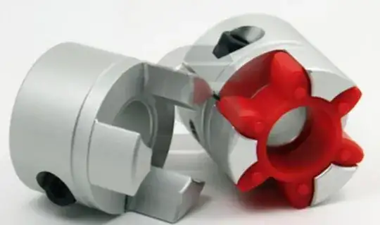

My question is simple: I want to make a dog clutch system for a wakeboarding cable system and was wondering if a flex (spider) coupler could used? The power, velocity, torque is similar to a go kart / lawn mower, atv etc.
Dog clutch:
Flex Spider Coupler (the one with a nylon/plastic insert)
