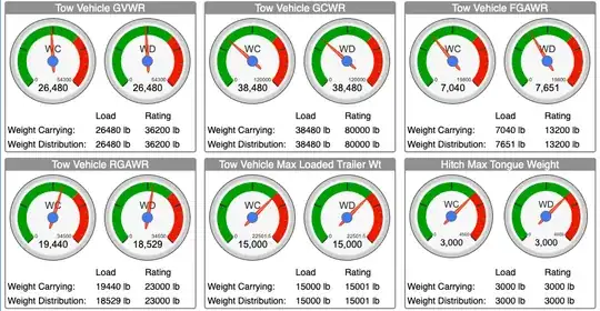

After I weighed the bus, I was able to do some simple math to determine the most limiting factor in towing the bus.
It is, in fact, the weight that can be put on the rear axle. With a GAWR rear of 23,000 lbs and an actual weight on the rear axle of 14,940 lbs, I'm left with an extra 8,060 lbs I can add to the axle. If I were to tow a 15000lb trailer, the appropriate tongue weight of 1500 lbs would add 1500*9 (13500lbs) to the rear axle. The moment added is far in excess of what the rear tires can support and likely in excess of the suspension's limit too.
Weight distributed hitch
With a modest weight distribution system at 2000lb tension and a 30 inch bar length and a trailer that is 15,000lbs and an axle 200 inches from the hitch one can determine (with the use of an online calculator :P):
I entered the following information:
The results are as follows:
According to this calculator (bottom, middle image) 15,001 lbs is indeed that max weight with this weight distribution system.
