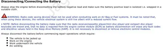

Edit based on comments: This is the advice for the Jaguar X type, page 48 of the pdf version of the workshop manual: enter image description here
