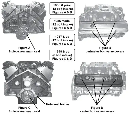

They stopped using the two piece seal in 1986. The 86 SBC was an odd one in that it still came with the perimeter bolt heads, yet went to a one piece rear main. Here is a graphic showing the differences compared to the years of engine manufacture:
https://bpi.ebasicpower.com/faq/gmsmallblock.htm
You'll notice the rear crank flange is very different on a two piece oil seal than it is on a one piece.
As far as the journal sizing goes, GM changed the size of the journals in 1968 to accomodate a design change in the crankshaft. Prior to '68, the main journals were 2.300" while the rods were 2.000". After the change, the journals were upped to 2.450" and 2.100", respectively.
What does this mean for you? Looks like you're looking for a block between 1968 and 1985. There are only about a billion of them out there, so shouldn't be hard to find one to suit your needs. Ensure you pull the casting number off of the back left corner of the block, then do a little research. Don't take someone's word for it before you purchase. Do your research.
