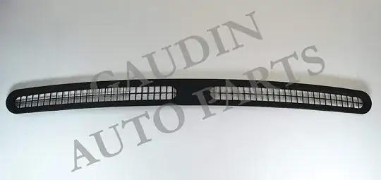

I have difficulties in removing front defrost vent grills front defrost vent grillsfor ford focus SE 2016 because some small gravel(stones) Slipped into it.
i tried to pull it but didn't work. i didn't find any clips or screws to unfasten.
can any one help me with that do i have to remove all dash? or is there another way to clean it?

If you can find an image of the underside, it will probably show some plastic clips. Usually one can use a small screwdriver or plastic tool to lift the grille close to the clip locations.
You will probably find that the grit has descended down the tubes further than you envisage... It is a good idea to get them out before they get to the blower motor - if they can they will...
