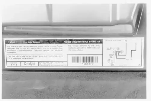

You can find the spark plug gap specifications on a sticker that will be either on the radiator support or on the underside of the hood (there are other locations such as the strut towers, etc). This is the gap that should be used when using the OEM spark plugs and even when using an off-branded plug that is a valid replacement for the OEM brand. Here are a few examples of what the sticker will look like.
(source: autozone.com)
