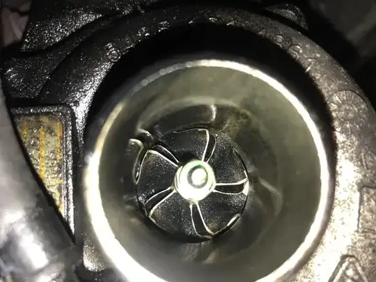

Latest update (5th March): Okay, so a friend and his mechanic friend with full diagnostic on his computer was able to take a look at the info from diagnostics, and also took a physical inspection on the engine. Physical inspection, immediately could say the turbo was done. Tonnes of play on the blades at compressor side (I've now felt a working turbo and realise it really should be solid!). It was also apparent the engine seemed to be starting on fewer than the full 4 cylinders. Diags revealed two injectors required (forgot the cylinder numbers for now).. Sourced a used turbo from local peugeot scrappers (engine is PSA, same as 1.4 HDi) for £60. Waiting to obtain some used injectors and find out whether it is imperative to replace the oil feed, uptake, return, and sump.. Once the work is done, I'll post a final answer on this in case it is of use to anybody else!

I took off the turbo IC air intake (between MAF and turbo) hose too... its a bit oily inside, and that smaller side hose leading off towards air filter area - some video called it an oil evaporator - well, that was oily, inside and out, and the connection it plugs into near the air filter was clogged with very solid oily gunge.
I'm not used to turbos, but would the MAF/air intake side be the condenser end? Either way, this is what it looked like inside... Obviously a bit oily, but I can't tell if the shape of the fins is morphed or totally fine. inside exposed turbo fins
