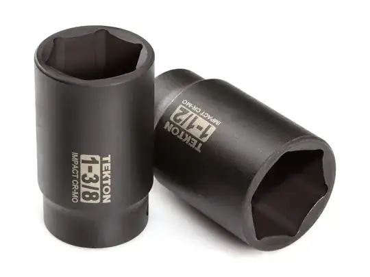

1) Select a socket that is a hexagon shape with what looks like rounded out corners (as if 6 holes were drilled then the hexagon were cut between them) like this:
These are much less likely to round a nut than straight hexagon or (worse) 12 pointed sockets (a hexagon overlaid on another hexagon). The reason for this is the rounded corners apply force not to the points of the hexagon on the bolt, but a few mm away from the point, where the bolt head is stronger. A straight socket applies force directly on the pointy bits of the bolt head, encouraging them to round off
