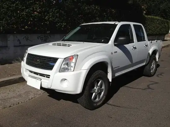

I'm not a mechanic or anything, but I'm too curious. I live in Colombia and I have a vehicle that is marketed here as Chevrolet Isuzu D-max 3.0 model 2009 (diesel engine)
I know that my vehicle has an OBDII port, but I need your help to identify a scanner that is compatible with my vehicle, in a website I found that it works with the 11bit CAN protocol 500kb. here url It is right?
I have seen different products on ebay, but apparently in the US this vehicle is not marketed and I can not find a product that specifies that it works
Can this product work for my vehicle?
Thank you very much for your comments and suggestions
