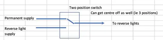

All you need to do is to use your toggle switch to supply the reverse light wire which runs from front to rear - from the reverse light switch.
The supply to the switch needs to be fused whether it is from ignition or permanent supply.
This assumes that the car does not have lots of computer control modules, which may require different options... But as you did not give make, model or year it was a fair assumption...
Edit, you could use a 2 or 3 position switch as so which would avoid the possibility of "back-feeding"...
