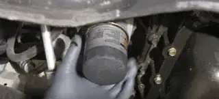

Is it close to being time to change the oil filter? Depending on its position, you should be able to spin it off without losing much more than the oil contained within (which should be ~0.5-0.75 litre). Replace it with a new (empty) one and run the engine for a minute or two then recheck the oil level.
  The oil filter seems to be a horizontal mount so it's going to be messy. However, it appears to be sufficiently above the sump that you won't lose any more than the oil in the existing filter.

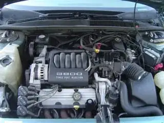

Depending on whether your oil filler tube goes into the block or into an OHV cover, you might be able to syphon off a litre or so through it.
Edit:
  Looks like you add oil through the valve cover so you can scratch option 2.
