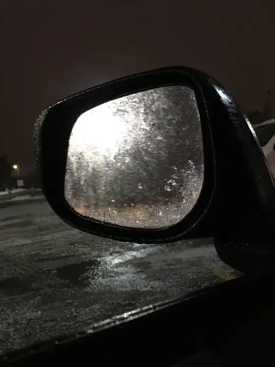

In response to the suggestions given here, I was going to throw some snow on the mirror face and see if it melted. Tonight, however, the weather cooperated and coated the mirror with freezing rain. I drove for 20 minutes, the first 10 on the highway. The ice melted away. On the driver side, however, it's not ideal. There's a margin around the lower and right border where the ice seems to persist: enter image description here
This doesn't happen on the passenger side mirror. I recall noticing that "bum" region being particularly coated with frost in the past, when I was still wondering whether the heater worked at all. I suspect, however, that this imperfect heating isn't due to the flooding. Perhaps the solution is just a matter of replacing the mirror.
