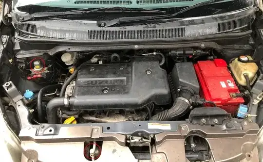

This model doesn't have a cap on the radiator, but the cap is on the overflow reservoir. The white jar towards the right of the battery has this cap.

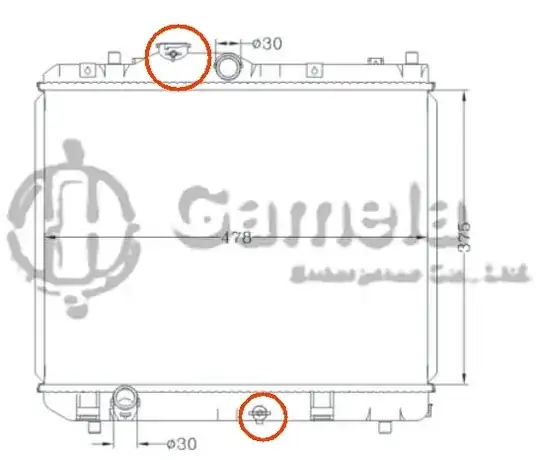

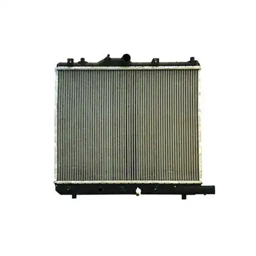

There should be a petcock valve in the lower middle of that radiator. Here's a picture; it's the white gizmo at the bottom. Take the radiator cap off before opening the petcock to allow complete draining.

This is the easy part (and the real reason I've added another answer to your question) ... Fill it up through the reservoir you pointed out in your picture. Your system has an expansion tank and will self purge. Coolant flows through this bottle at all times and allows air in the system a place to be captured. Fill it up to the line while the engine is running with the cap off. Put the cap on and run it, check/fill it again after running. Check on the levels every day for about a week or so, then once every month thereafter (normal maintenance) to ensure it stays up to the line.
