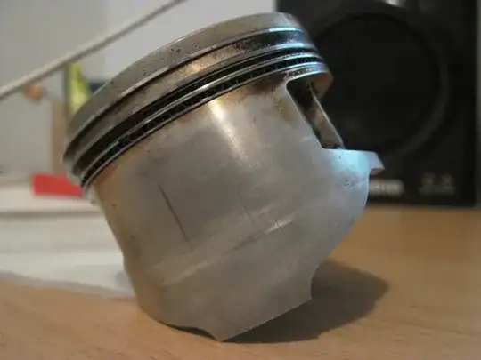

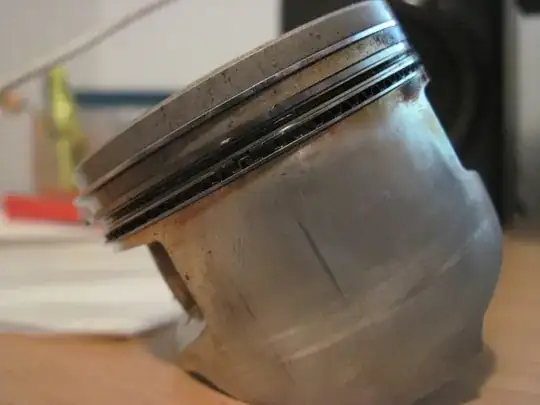

I don't want to say much but I fixed everything I had the tools to do. Professional technicians told me that there is a problem with the piston/ring/cylinder.. and that it needs to be fixed... So I did... Cylinder got larger by 0.5mm ...
Here are some photos of the old piston... Do you see any problem with this piston?
Because i find that is has little problem an cant explain how this condition can cause so serous oil consumption problem? piston picture 1 http://dl.dropbox.com/u/4499990/sites/IMG_3760.JPG
piston picture 2 http://dl.dropbox.com/u/4499990/sites/IMG_3761.JPG piston picture 3
http://dl.dropbox.com/u/4499990/sites/IMG_3762.JPG
Until now, after the service it seems to be running well... Oil level seems stable for the first 200 km.

To make sure I answer correctly let me make sure I understand the question.
The engine was using 1.5 L of oil per 2000km, you did the following repairs to the engine:
Valve job including replacing the exhaust valve. Bored the engine 0.5mm over New 0.5 mm over piston and rings
Now that the repairs have been made it seems to be fixed. It's running well and has not used any oil after the first 200km
You are curious if the piston was the cause of the oil usage because it doesn't look that bad to you.
Visual inspection while important won't always tell you if it should have been smoking. It looks like there is deep scoring on the skirt, I would need to feel it to tell for sure. If the machine shop needed to bore the engine 0.5mm (0.20") over it was most likely worn close to that already or it took that much to get the scratches out of the cylinder wall.
If there was that much wear on the engine it most certainly would have been using oil, and visibly smoking. If there is too much play between the two then oil gets past the rings and ends up going out the tail pipe.
If the bore has been honed and rings replaced then perhaps the issue is with the valve stems. I once had a CBX250 bike that blew a lot of smoke. It was a 4-stroke, like yours. In the end, it turned out the value stems were leaking oil into the cylinder.
Does your bike produce a lot of smoke?
