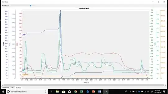

Tunerpro RT - scan data of a highway run

Your best bet here is to figure out why it's knocking and fix the issue. Even if carbon buildup is the problem, there are better ways to get it cleaned out, such as fuel injector cleaner. High end products such as BG44K (no affiliation) may do the trick and will do it without damaging your fuel system. You could also do some data logging to see if the knock sensor is working correctly or if it's actually knock (or pre-ignition) which you're hearing.
