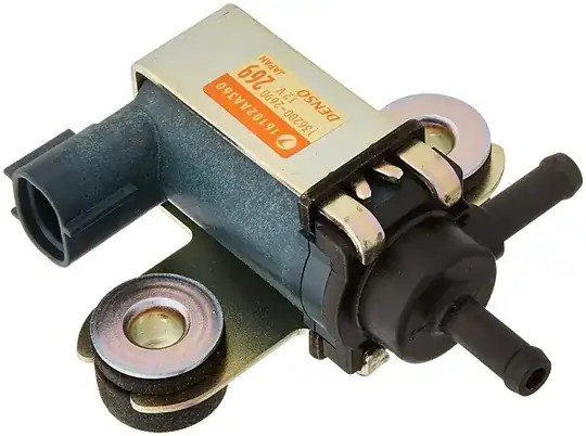

For a 2004-06 car that is DENSO part # 16102AA360:
2 Port BCS - 04-07

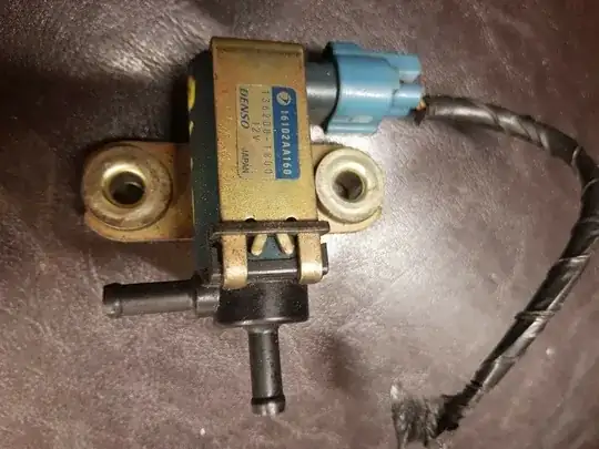

For those with an 02-03 car it's DENSO part # 16102AA160:
2 Port BCS
Which is basically the same but the electrical connector is on the other side.
