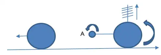

With the handbrake on, the rear wheel is not able to rotate. When the foot brake is released the car will try to move forward. This will cause a rotational force on the rear tire. Since the rear tire cannot turn, the rotational force will be transferred to the axle mounting point 'A' which will cause the road spring to compress, hence lowering the car body. If you did the same thing going up hill, you will find that the body raises instead.
