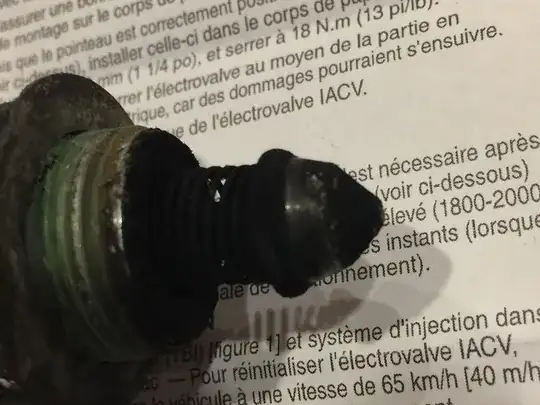

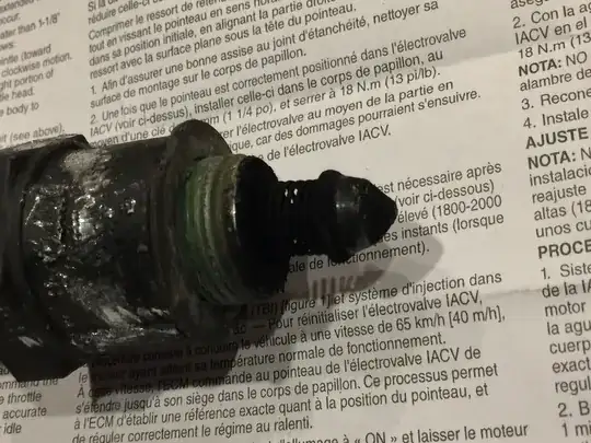

Thanks to Paulster2 for suggesting to check the IAC. This is what it looked like when it came out:IAC
IAC
I think it is extremely carbonized. I didn't bother cleaning it, just replaced it and it started and idled and drove it for a test and all seemed fine. I'm still not convinced it's fixed though.
