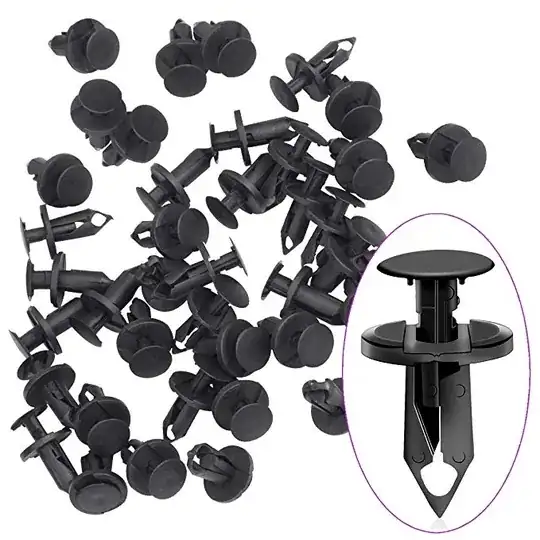

Put a screwdriver in the slot on the side and gently raise up the center section. You may need to work it from both sides. Once the center section is raised, it should look something like this:
Image from Amazon.com
Once the center section is raised, grab it from the base (or put your screwdriver under the base) and wiggle it free.
