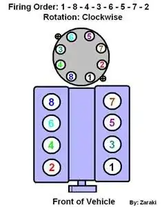

Second thing is, it sounds like the timing is off. It could be either 180° out (doubtful from how it sounded with ether), or you might have your wires out of order (more probable in my mind):
  • Double/triple check to ensure your wires are on there correctly. The firing order for most Gen I SBC's is 1-8-4-3-6-5-7-2 ... When you check each lead, follow it completely to the end ... don't make assumptions.
  • Ensure the distributor rotor is pointing to the #1 cylinder at TDC.
    • Pull the #1 spark plug, place your thumb over the hole, then have someone bump the starter a little at a time until a large rush of compression comes out the hole. Look at the timing mark on the harmonic damper and bring it all the way to TDC (0° to the timing mark).
    • Pull the distributor cap off, noting position of the #1 spark plug lead. Normally, this is located at about the 5 O'Clock position:
More than likely, both of these things (fire & fuel) are at issue with your trying to get it to start.
