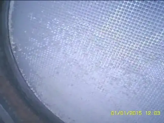

While I had the old one out, I decided to stick my handy new Teslong borescope into the downstream port. I've attached some pics of the tail end of the Bank 2 CAT. Definitely shows some deposit at the lower end of the substrate. But it is white, so I suspect phosphorous and/or ash.
This looks like ash build up to me, but I'm NOT a trained mechanic with emissions expertise. Hopefully some of you are! :)

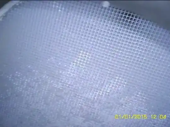

It appears that at least part of the substrate's channels are not collapsed. I could've open the upstream sensor port of put a bright light in to make a better determination.

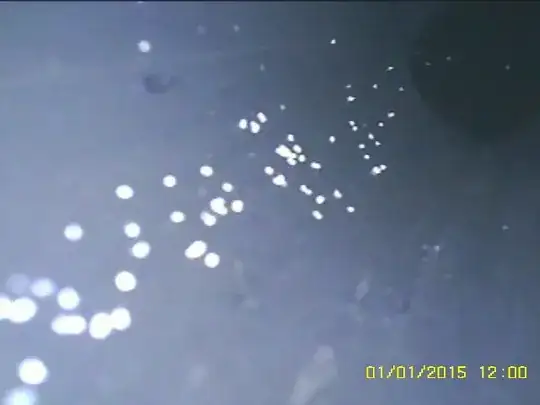

I also decided to look the other direction, and there was white debris trailing down the bottom of the pipe. I know substrate could be crumbling out. But it was a very windy day, and as I was scoping it, wind was whipping all around me and into the pipe. The debris blew around like styrofoam beads. Ie, it was very light material. It almost looked like the white debris on the ends of the lower substrate getting blown out of the CAT. Which makes me wonder if the Catacleans did have some positive effect in dislodging some of the build up.
This must be the same white material from the bottom side of the substrate. It is light weight too. The wind blew this stuff around like Styrofoam beads. This also make the think it is an ash of some sort. I would think that crumbing substrate would be more weighted down with metal oxides.

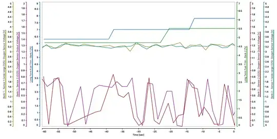

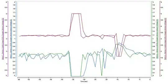

While on my Interstate drive, I did have OBD Auto Doctor running on my Macbook Pro. Below are a couple of screenshots from that capture. I think the downstream sensors are reading correctly, but now that I'm suddenly seeing codes on both banks, I'm suspicious that something else further upstream is causing these.

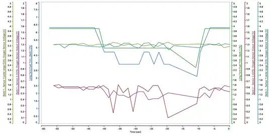

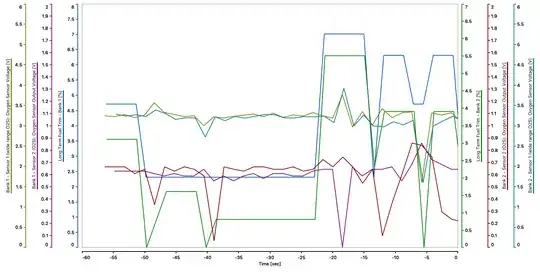

Using OBD Auto Doctor (paid version), I captured some plots of the upstream and downstream sensors while on the Interstate drive. Here I had slowed down for a cop helping a stalled motorist. Then I promptly resumed my cruise speed. Using OBD Auto Doctor (paid version), I captured some plots of the upstream and downstream sensors while on the Interstate drive. Here I had slowed down for a cop helping a stalled motorist. Then I promptly resumed my cruise speed.

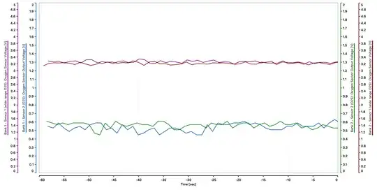

Yet another plot while holding 80mph under cruise. The downstreams are calmer, but still look more jagged that I would think they should be. Yet another plot while holding 80mph under cruise. The downstreams are calmer, but still look more jagged that I would think they should be.

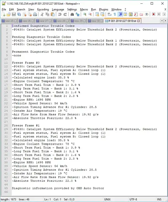

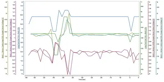

UPDATE 1: Adding Freeze Frame data

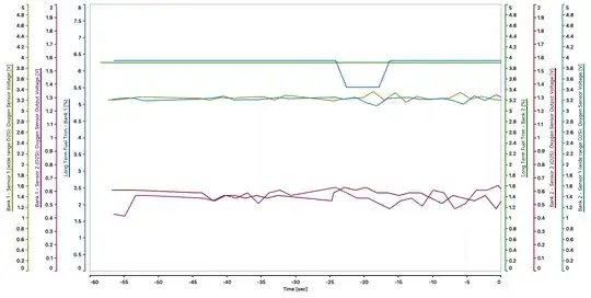

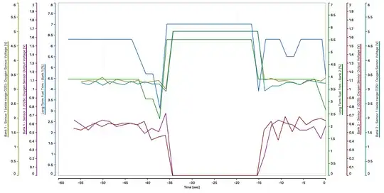

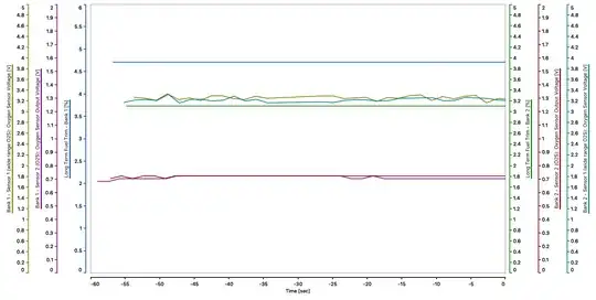

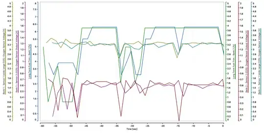

UPDATE 2: Adding graphs with LTFT B1B2 Idle and 80MPH Cruise Control (CC).
Please excuse the number of them as I added more than just idle and 80mph as it appears to my untrained eye that there's a weird disparity going on between LTFT B1 vs B2 in many cases. What would cause this?? I would think fuel supply to both banks would be on par with each other.
Why would one bank be appearing to get more fuel than the other??? Timing? Fuel injection issue? Fuel economy is down, so something is telling ECM to feed more fuel than normal, and it appears to not be spreading it equally between each bank. I suppose a more heavily degraded catalyst on one bank could cause this. But is there anything else upstream that might also cause this? I've read that a new CAT will end up suffering same fate if an upstream issue is really to blame.
20181230 1239 31 idle begin1 warmed-up 20181230 1239 31 idle begin1 warmed-up in-driveway

20181230 1323A 38 accelration 80MPH on-cc 20181230 1323A 38 merge+accelration to 80MPH then on-cc
20181230 1324 39a 80MPH on-cc level cruise at 80mph on-cc
20181230 1327B 39 80MPH down-up-hill on-cc 20181230 1327B 39 80MPH down-up-hill on-cc
20181230 1328 39e off-cc 80mph cruise control disengaged - foot off gas pedal
20181230 1338 LT DIFF B1B2 39h 4000RPM burst 50-60mph on country road ending with 4000rpm acceleration burst
20181230 1355 39 end2 idle Back home, driveway, idling - Note persisting diff in LTFT B1 vs B2 while A/Fs and O2s now calm!
