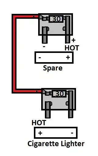

Here's another schematic of this possible idea:
Schematic of 2 Fuse Tap pigtails
It should work because the HOT from the cigarette connects to nothing and no longer powers anything constantly. And the HOT from the spare travels via 2 fuses and the red cable to power the cigarette.
Don't forget: It's super important to get the polarity correct! In this diagram, I purposely REVERSED one of the pigtails (so I don't need to solder any wires into the fuse hole).

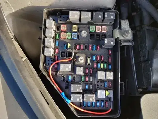

Edit:
Here's a photo of me successfully carrying my HOT spare to my cigarette lighter:
Joining 2 fuse taps in serial
