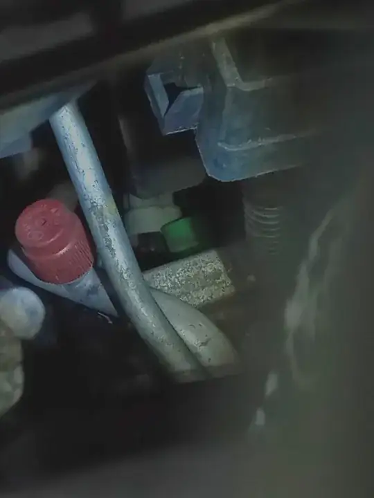

Update: After being asked whether the 'energizer wire' was hooked up, I went back and opened up the hood, and from the limited view from the top I was eventually able to spot the following (see image), what appears to be a disconnected cable at the very back of the air compressor, which I wasn't able to see earlier when I was looking at the compressor head on from the side panel of my car (On this vehicle the air compressor is located behind the passenger side tire near the ground, behind the firewall)
I can't see this connector clearly enough to see what that inside bit of that white connector is, but it does look as if that's supposed to be sitting on that round orange bit next to it (apologies if that's not orange I'm color deficient)
