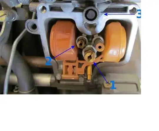

These are the exact jets and shims that you will need for your 1984 Honda Gold Wing GL1200
four Main jets size 118
four Pilot jets size 38 and
8 shims for each Slide Needle, 2 shims per needle
You will also need to the following
1 D-Adjuster for fuel screw adjustment
Legend
  1. D-Adjuster for air/fuel on idle circuit
  2. Pilot Jet
  3. Main Jet
