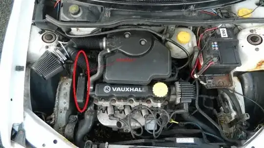

Vauxhall/Opel Corsa B-Type (MkII) would be the best car to learn servicing and repairs. Over in the UK, I could get one for about £200. They are ridiculously easy; For example, a Cylinder gasket replacement involves removing a couple of bolts, the timing and Aux' belt, a few bolts, take off a few hoses and wires and then pull the whole thing out of the engine bay. One of the easiest cars to work on for big engine jobs.
Plus, with the amount of rust these suffer with, it'll get you prepared for that side of auto-mechanics, too! ;) Plus, the filters are right in sight; You can see the air filter right there (though, it usually looks like a black box rather than this terrible, short-sighted POD filter) and the oil filter is right on the front of the engine, though I do despise these sideways-mounted filters. Fuel filter, they're usually along the frame line under the car near the fuel tank, except in the earlier models where it was on the top of the fuel tank.
And if you mess something up, who cares? It was £200, you could probably buy whatever you broke for 20 pence, lol. There are a few things to note with these vehicles, however..... enter image description here
