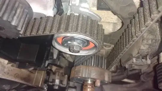

I'll be changing the timing belt and water pump on a 2006 Volvo S40 with a 2.5L T5 engine. What is the torque specification for the tensioner on the timing belt?

Just looked up the workshop manual and it is 24NM
Nothing more I can really add to be honest, although most of the time if I cant find the workshop manual I just look up a metric bolt torque chart and go from those figures
