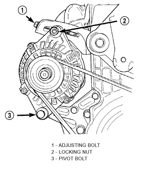

EDIT: It appears that I need to tighten the tension on the alternator belt using the Adjusting bolt; I found a diagram that more accurately represents this setup (below)

The alternator actually pivots around the lower bolt, so you can remove the belt. The other bolt will be in a slot not a round hole, and the position of the bolt in the slot adjusts the belt tension. You didn't tension the belt enough when you refitted the alternator.
If you can find some instructions on how to change the belt they should tell you how tight it should be, but if you can depress it more than half an inch with your fingers (when the engine is off, of course!!!) it's probably too loose.
Loosen both bolts, then push the alternator as hard as you can to tension the belt while you tighten the top bolt. Then tighten the other bottom bolt.
You can see the guy demonstrating how tight the belt is, at about 3:20 in the video you linked to, but there wasn't a very clear description of how he was judging the tension was correct (and to my eyes, in the video it looked a bit loose).
If the electrical load is constant, the tension in the belt reduces as the revs increase, which is why it only squeals at low engine revs.
