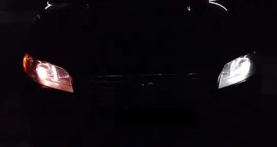

My 2014 Volvo V70 D4 started having issues with the headlights. On the right side, the low beam (and also high beam, same device) are at perhaps 70% effect and have a noticeable purple tint.
I also noticed that on the left side, the orange side light (same enclosure, but to the left of the blinker) is not lit at all. I do not know whether this is a LED or incandescent bulb.

Car seen from the front
Edit: Thank you, car, I know.

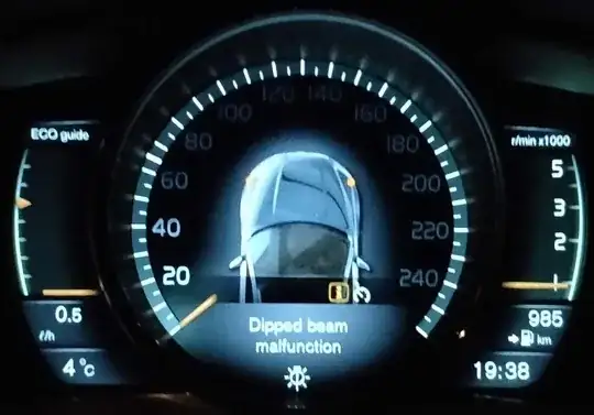

dashboard warning

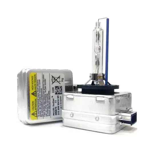

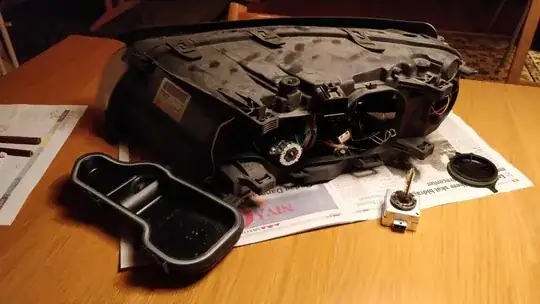

It turns out that the bulb is not an H4 or H7, but something that is called a D1S which is not exactly cheap, but can certainly be replaced without replacing the entire headlight enclosure. There's enough of a base on the bulb that I don't think Paulster2's recommendation to wear gloves is critical.
example of a D1S Bulb headlight assembly removed
On a modern Volvo, headlight bulb replacement is extremely accessible. I'm sure lots of people would love to see other manufacturers doing the same.
