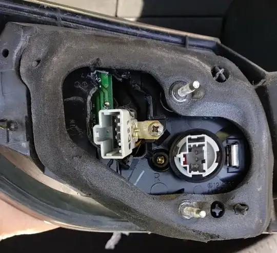

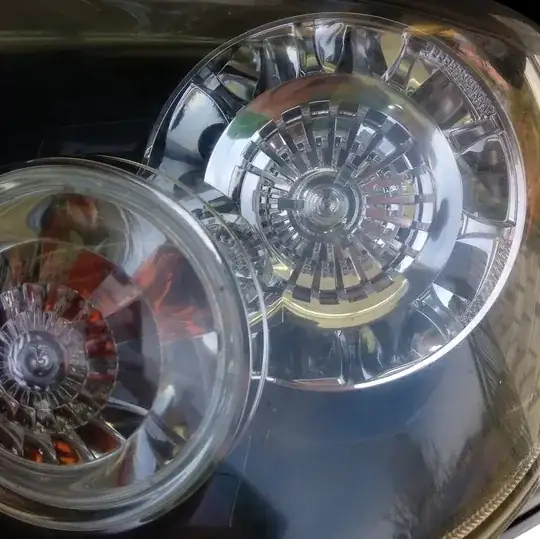

Some photos: enter image description hereenter image description here

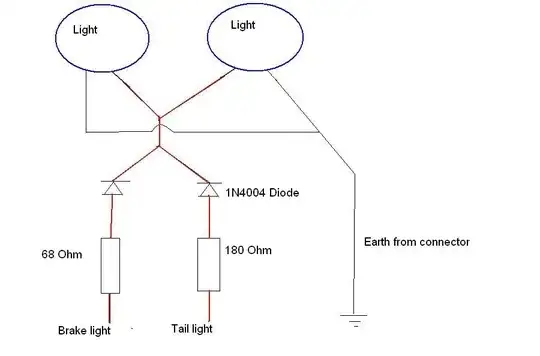

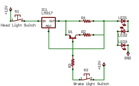

EDIT2: I've found a DIY tutorial: https://www.sau.com.au/forums/topic/371044-diy-led-tail-light-and-brake-light and a schema as seen below enter image description here If the original manufacturer (MAZDA) has used the same schema what has possibly gone wrong in my scenario? A blown resistance or diode rectifier shouldn't make the whole circuit off in case when voltage is applied at brake wire. Or they use a more complex circuit like this? As I saw at the circuit there were a lot of resistors looked like one resistor per LED. enter image description here

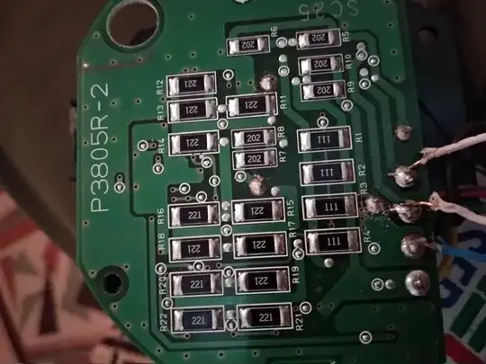

Does anyone know how this resistors are connected R111= 110Ω and R202= 2kΩ and how does the circuit switch from one circuit to another enter image description here

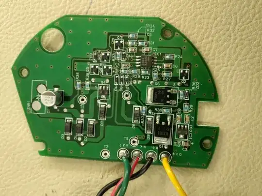

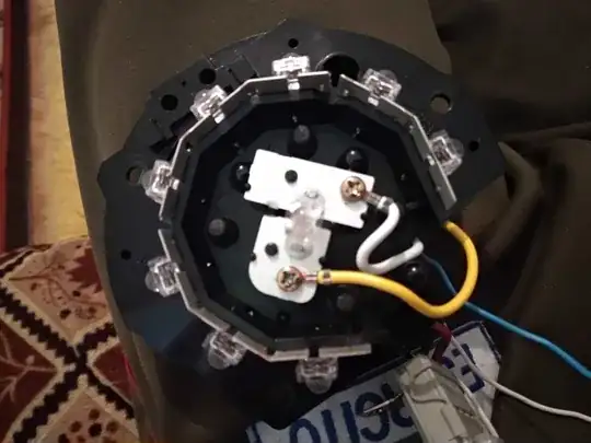

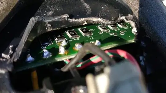

After searching around I try to cut it open this weekend and the result was a complex circuit for my understanding. I'm post it here if someone is interested to see or explain how it works. So I ended up removing the whole circuit and creating a simple circuit with resistors and 2 diode the classic old way and hope that the LED want burn quickly. enter image description here enter image description here enter image description here
