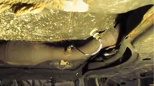

I would bet the O2 sensor is not removed. The reason I say this is, you'd hear a very annoying puffing sound from the hole left behind. Instead, I'd suggest the O2 sensor is probably in there and hooked up, but the car has not completed its drive cycle yet. A drive cycle is the where the car does its readiness checks for the emissions related items it looks after. Once the drive cycle is complete, the CEL may or may not come back on, depending on whether the O2 is reading within spec or not. The mechanic is right, though, the car would function completely well without it because these cars do not utilize the rear O2 for anything other than checking the operation of the catalytic converter.
If you'd like to check to see if it's actually in, you can take a look for it. You should be able to see it about center of the car looking just behind the tire on the right side. Here's what you're looking for:
