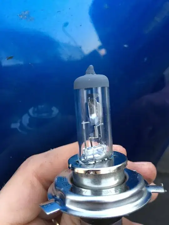

1) a defective bulb, each bulb has two filaments so while the high may be fine the low may have failed

Each headlight bulb has two filaments, one for dipped and another for full beam. You can see through the glass of the bulb to check if these have blown. If the plastic is too cloudy to see from the outside you will have to remove the bulb. enter image description here
