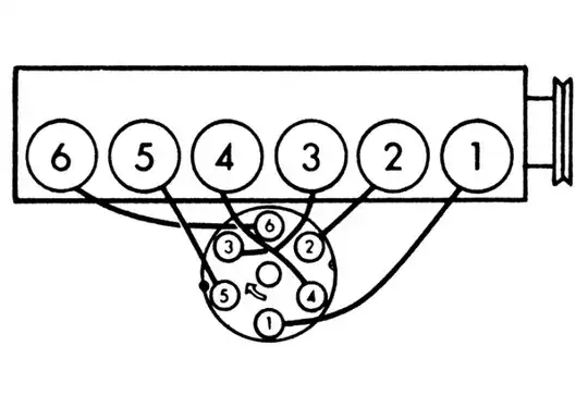

Carefully double check your spark plug wire locations (firing order). It would be very easy to have them in the wrong locations. Check each spark plug wire from the cap all the way to the plug; don't assume it's going to the right place, ensure it is. This would lead to what you're describing almost exactly. Here is the firing order for the 4.0L I6 engine for you:
